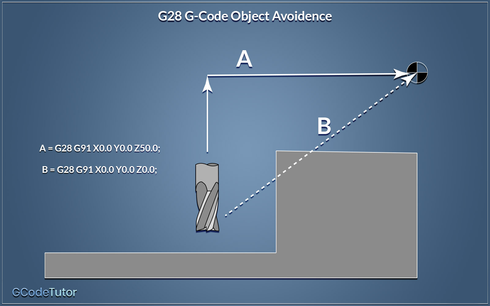

I’d check your machine’s manual or documentation to first see if that gcode is supported, and how it works with your system specifically. In general, you do seem to be on the right track. If you specify an x y z coord in your G28, your machine will go there before returning to your local zero.
I found a graphic that explains this well on gcodetutor:
Hope this helps!
