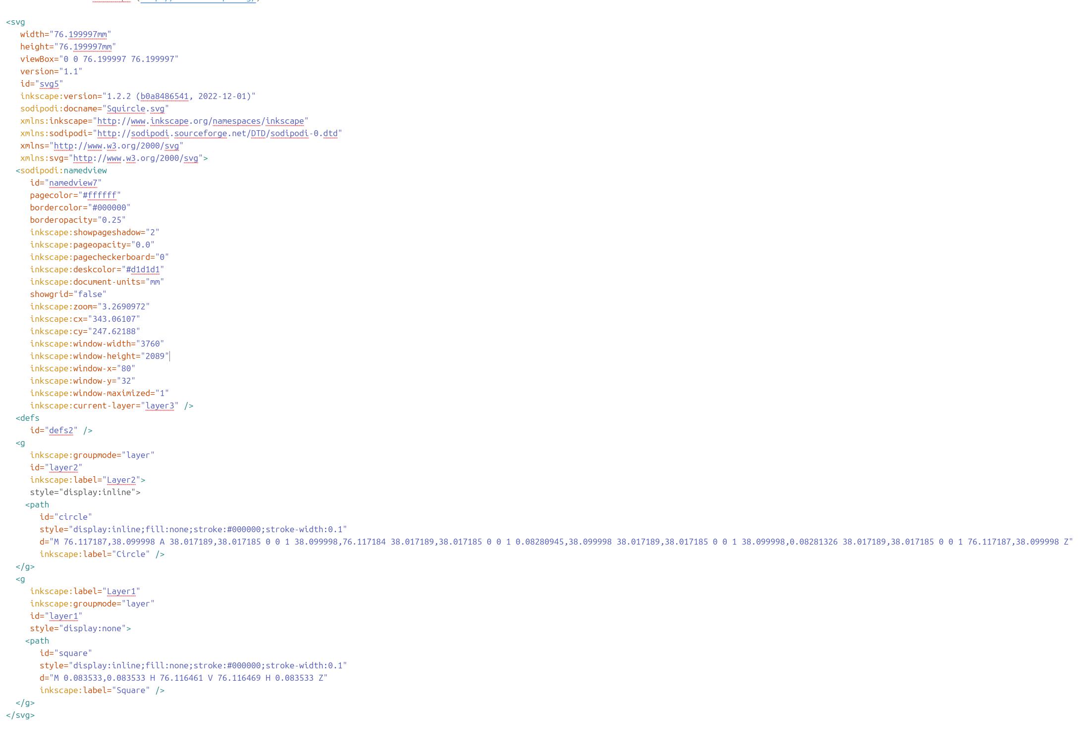

I want to make the bug repro as simple as possible, so I created a simple circle inside a square with those path shapes in different layers.
I have a much more complex file that I created but cannot use in Kiri:Moto because I cannot process all of the paths in one job.
Is there any chance of getting this to to work? If not, is there a workaround besides just creating an explosion of files for each?
I cannot upload an SVG file, but here are the contents of the file I’m using to reproduce the problem:
Basically, it doesn’t seem to respect this:
style=“display:none”
