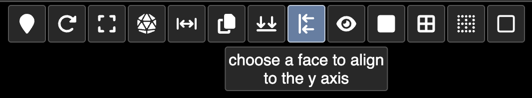

I have pushed the first dev version of 4.4 to the dev server if you want to test. I’ve added a “left align” feature borrowing from the “lay flat” code. so after you lay flat you can follow that with a left align. then 90 degree rotations are simple if you want to re-orient to another face.
I did a quick test and no issues…. works…..if I see an issue I will post
