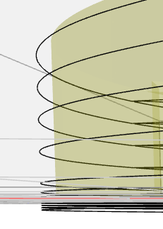

I want to cutout an item in wood. I set the tool and operation parameters, but I keep getting some extra slices below the bottom of the stock.
(4 in this image)
Is this intended for the finishing? It will dig into my floor, right?
My operations are just Outlines with different depths, with lower Z step-downs as I approach the bottom of the stock.

when you say extra outlines do you mean it repeats the same cut? you have enabled z thru which will add extra depth cuts beyond the bottom passes. that may be conflicting with the way you are using z top and z bottom overrides. I’ve never seen this pattern of outlines used before.
That was it! Thanks a lot!
