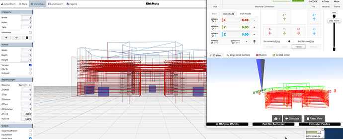

I try to generate Gcode with Kiri:Moto and check teh generated code with openbuildcontrol or ncview.com. On Kiri:Moto the model is above 0 in z-Position and when i view the generated code in other applications, the model is with his thickness under the z-zero. Is this an error or my fault ?

Do you have origin top checked? Do you have show origin enabled in preferences?
Origin top will set Z=0 to the top of stock which will then show the cutting below the plane in ncviewer.
Thank you stewart Origin Top was the problem.
show origin was enabled. This was a high speed help. Thank you
