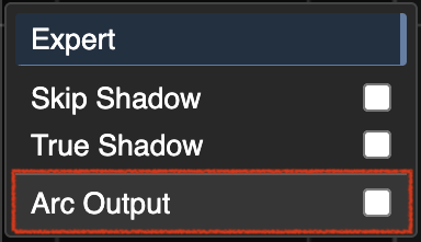

line 14 is a gcode arc command. if your GRBL does not support that then disable arcs under the lower left expert menu.

I don’t see that option either in versions 3.9, 4.0, 4.1 or 4.2. In mine it looks like this:
what is your exact version? I’m looking at 4.2.3 on grid.space and that has the option to enable/disable arcs.
Well, I’ve set Arc Resolution to “0” and it works! But I’m curious where you got your screenshot from, which version? Or is it in a different section to where I sent you my screenshot?
Thanks so so so much, Stewart! You’ve saved my day and most likely the whole week as well.
Greetings from Spain

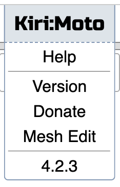

I’m here: Kiri:Moto and when I click version in the top middle, it just offers me up to 4.2
When I load Kiri from grid.space and hover the middle menu, look at the version # on the bottom of the menu. The other screenshot was with dark mode enabled.
Mine says 41.10, but I when I click on version, I’m at the highest option offered, 4.2
BTW, I’m using the online version.
are you running on app.grid.space? sorry, I forgot to update that endpoint. use grid.space if shift + reload doesn’t fix this.
I’m very confused with the versions! I need to keep trying on that. But the important thing is you solved my problem and I’m now cutting my part! Thanks so much again, Stewart.
