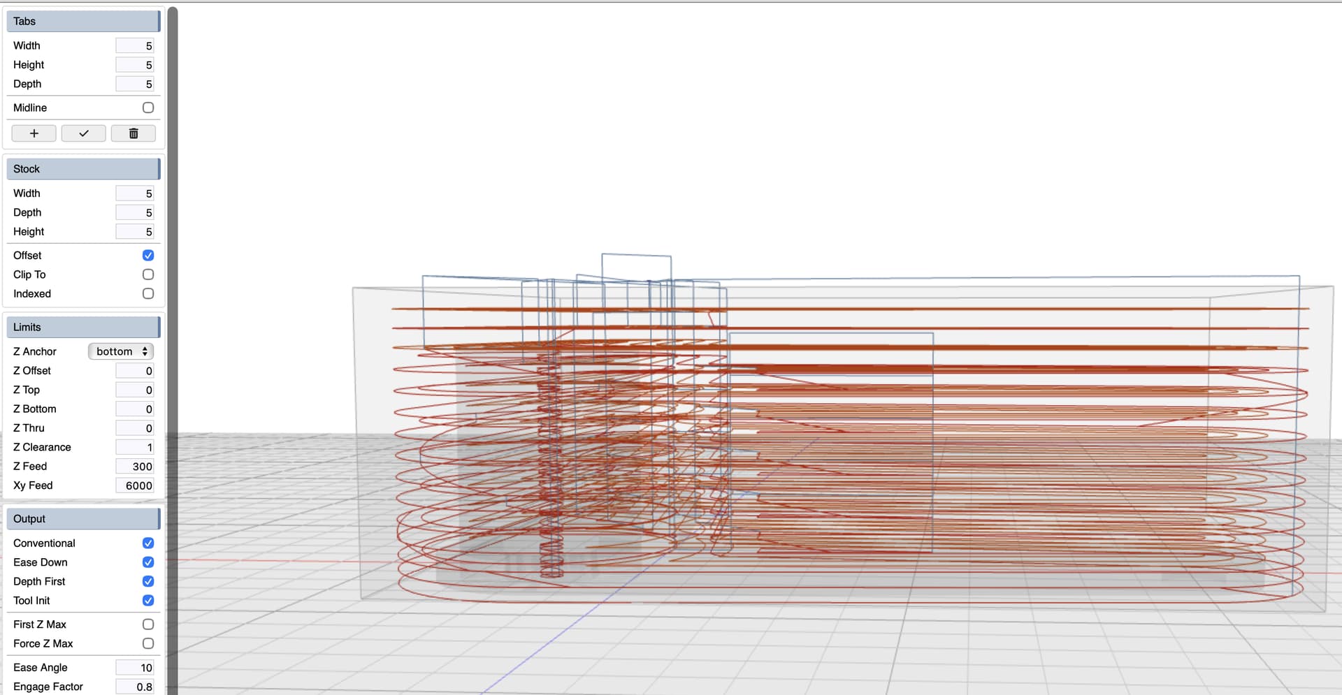

I have designed a fairly simple part and am trying to get ease down to work. It’s working great in preview for the main part of the work except for the first step. The tool plunges into the stock without an ease down to begin the roughing operation.
What could cause this?

the path generator requires refactoring in order to fix a few ease-down missing cases. it takes a lot of historical explanation of the code evolution, but at present, the “top” clearing of the part is not integrated into the ease-down code path. this will be fixed probably in the release after the next one.

As of now, there is no way to start from outside the stock. I’ll get started on a fix today, and as Stewart said, it will be in a release soon.
I have good news actually. Your ease-down issue seems to have been solved in release 4.2!
You can go to Grid.Space Chooser to change your version.
Hey! I noticed that it works after the first step down. However, the first plunge from the top of the stock is still vertical and not easing down if I read the G code correctly.

The work around I’ve been using under Overrides setting zTop to be just Above my stock so the first step down is just above my stock. if it’s 9 mm stock and 3mm step down I set zTop 12. Takes a bit more time cutting into the nothing for the first pass, but at least saving my drill bits.
