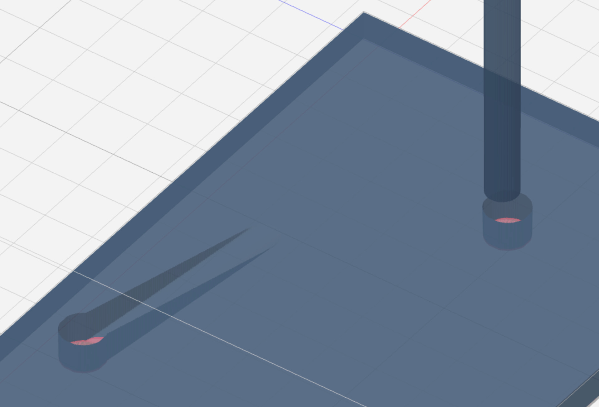

The combination of Ease Down with Roughing Faces causes the tool path to crash into the part. KMZ attached. Version 4.5.

confirmed. will investigate. thanks for the workspace.
a fix is up on the dev server. lmk if it works for you.

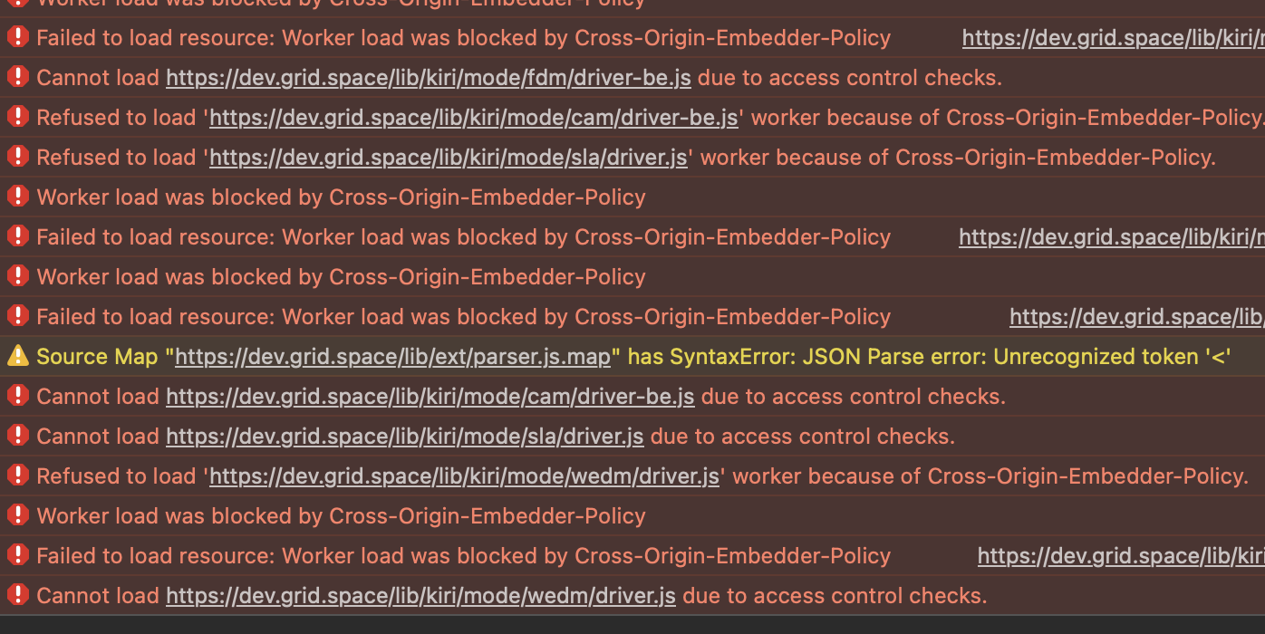

I wasn’t able to test this on the dev server. The slicing operation does not generate any traces and the part remains red. I see a lot of errors in the dev console (version 4.6)
can you try a browser other than safari? it’s throwing CORS errors which none of the other browsers seem to be doing.
All good in Chrome! Thank you and happy new year!
