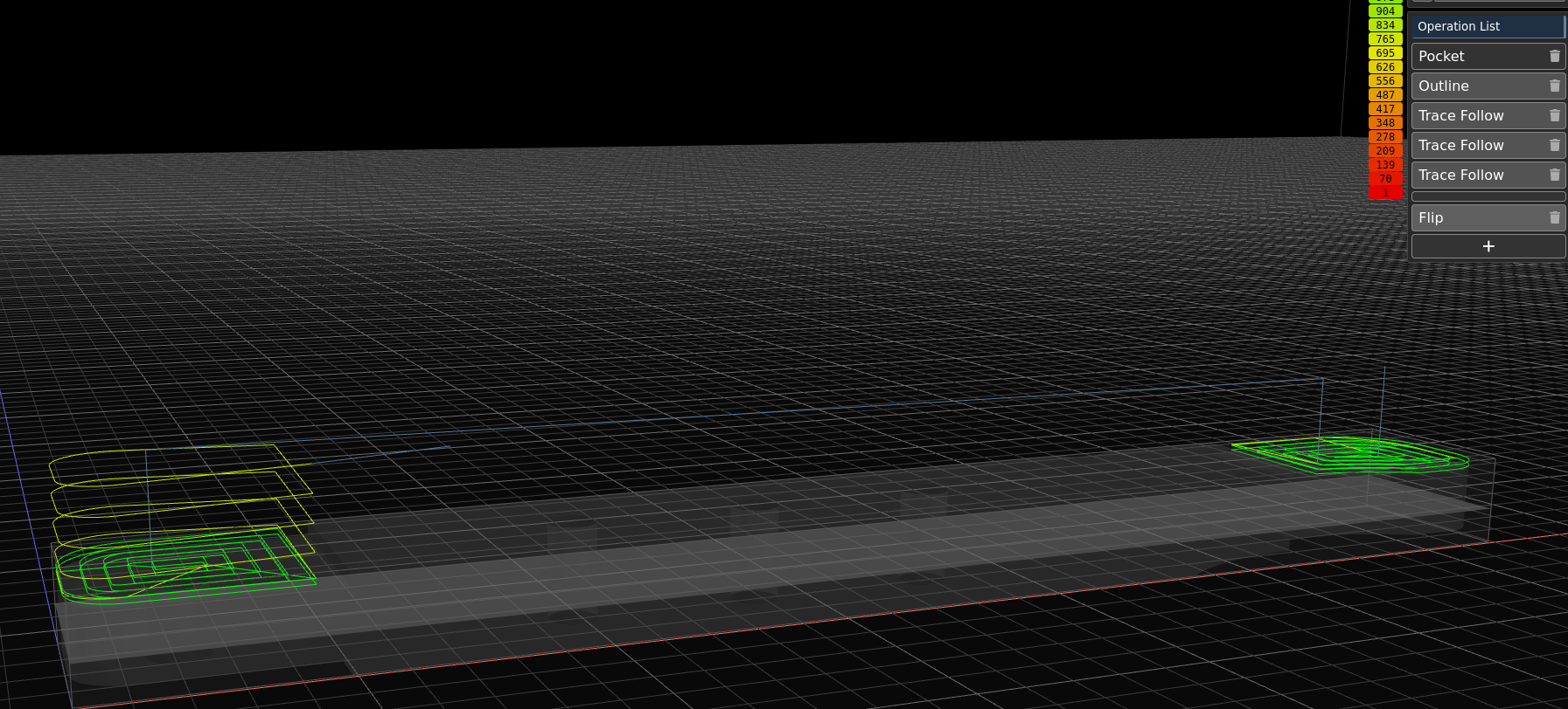

Tested with my “horror part” (same end mill issue…) but with pocket and can see some major improvements. However, there are some downsides as well… :wink:
Can DM the kmz if you like to have something that covers lots of ease down aspects in one.
It also has some weired issues with reverting inside and outside in trace operations. Part was designed in FreeCAD. I checked the normals in Blender. Part is ok.
Just realized: issue is that ease down in some cases starts operating down from Zclearance
please share any workspace that tickles bugs
