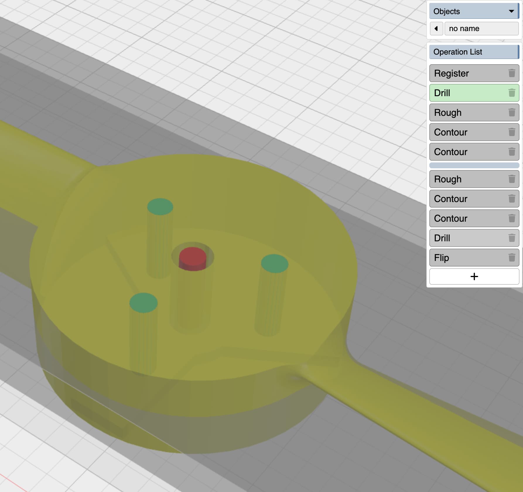

I am wanting to drill 3 5mm holes with a 5mm bit. The animation worked last week.
When I attempt this now I am offered select or select matching sizes. When I attempt this a small screen pops up which says analyzing parts…
I have not been able to pick a hole, nor an oversize hole.
Any thoughts?

try deleting and re-creating the drill operation. if that doesn’t work, please try to attach your .kmz here. Email it to me if that fails. thanks
Hi Stewart,
Recreated and merged just because I thought it might make the difference.
workspace_merged.kmz (519.9 KB)
David

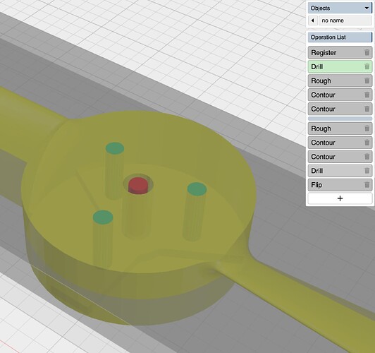

THank you Stewart.
I tried that but no change for me. Recreate is using the garbage bin and then picking the drill again?
much apprecaited.
David
yeah, just bin the old drill ops and re-add to use the new features. did the kmz I dropped here work for you?
It did!

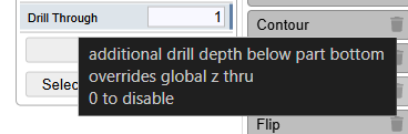

Still figuring out things like drill beyond (z extend) the bottom of material. I am sill getting way too deep.
THank you I am going to take a run at actually cutting this thing.
David
Hey there,
To change the z-extend, you need to modify the drill through param on the drill operation. it overrides the z-through set in the left tab.
Will give that a try thankyou.
