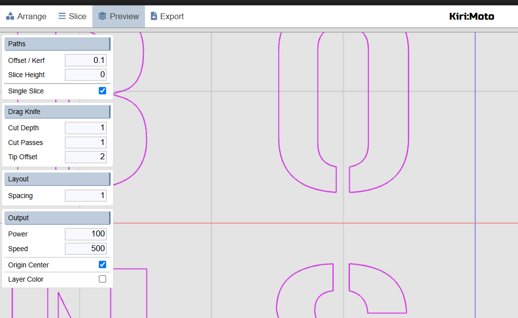

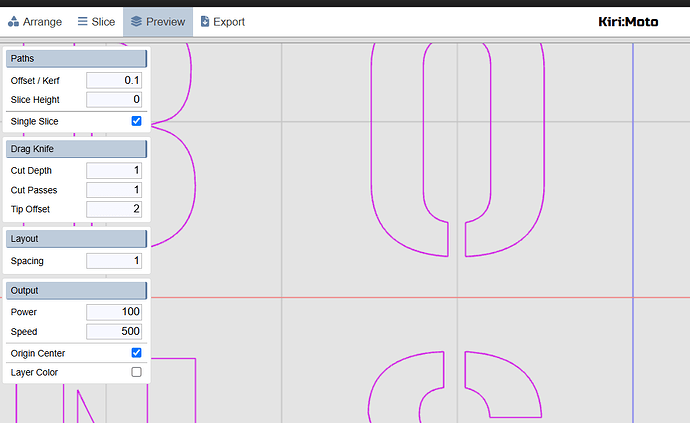

For some reasons the drag knife offset (distance between rotation axis and tip of the drag knife) does not work any more. There is no difference after slicing between differen drag knife offsets. Please see the screenshot for details.
I am pretty sure this already worked in the past. What I am doing wrong?

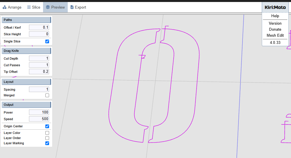

Dear Stewart! Thank you very much for the reply and the hint. - In Version 4.0 it works as expected.
An now I know how to change the version properly. I tried to do it before posting. At first, I did not get it that I have to SHIFT+reload to change to the old version (and not to the actual version again). I was always wondering why it was still the current version…
