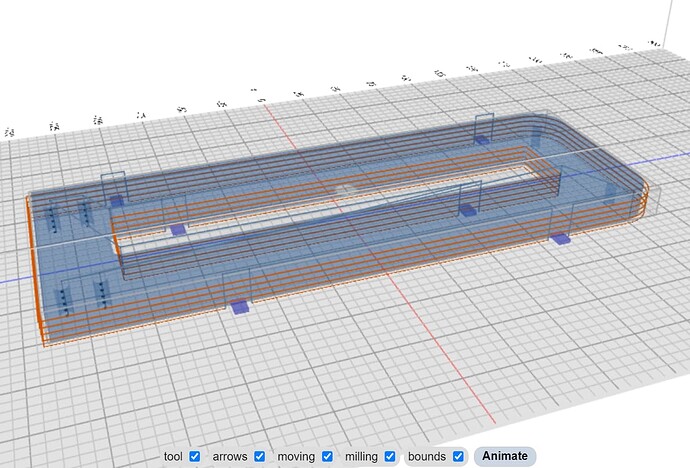

Can you tell me what I missed, that Kiri divided the inner cutout into sections? Besides that it produces extra passes, which do not seem to be needed.
Thank you for your advice. ![]()
DoublePass.kmz (318.9 KB)
Since there is no need to use “rough” for this operation, I switched to “outline” and “voilà ” it worked like a charm. ![]()
ok, that is really odd. let me see if I can figure out what’s happening in roughing to cause this.
