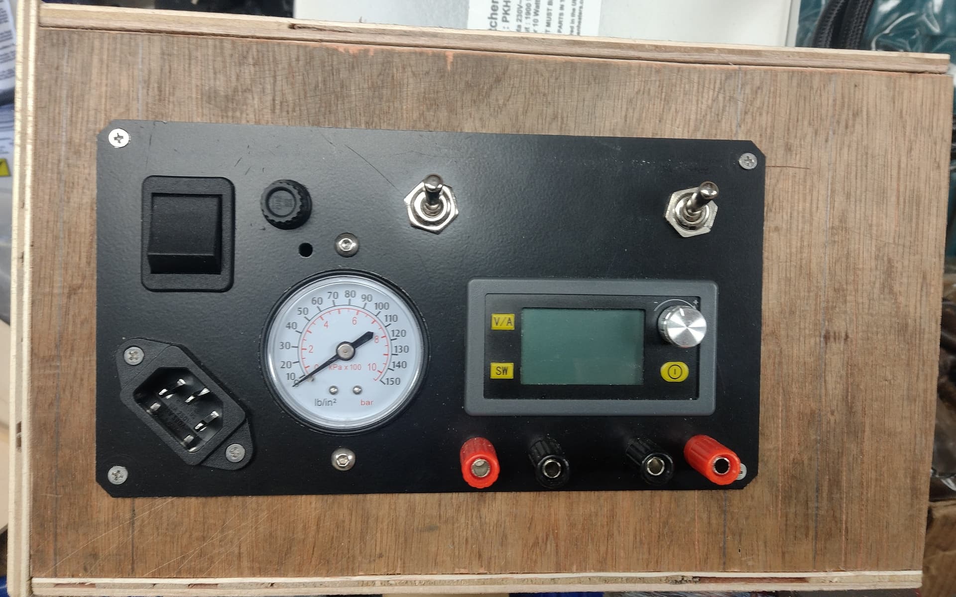

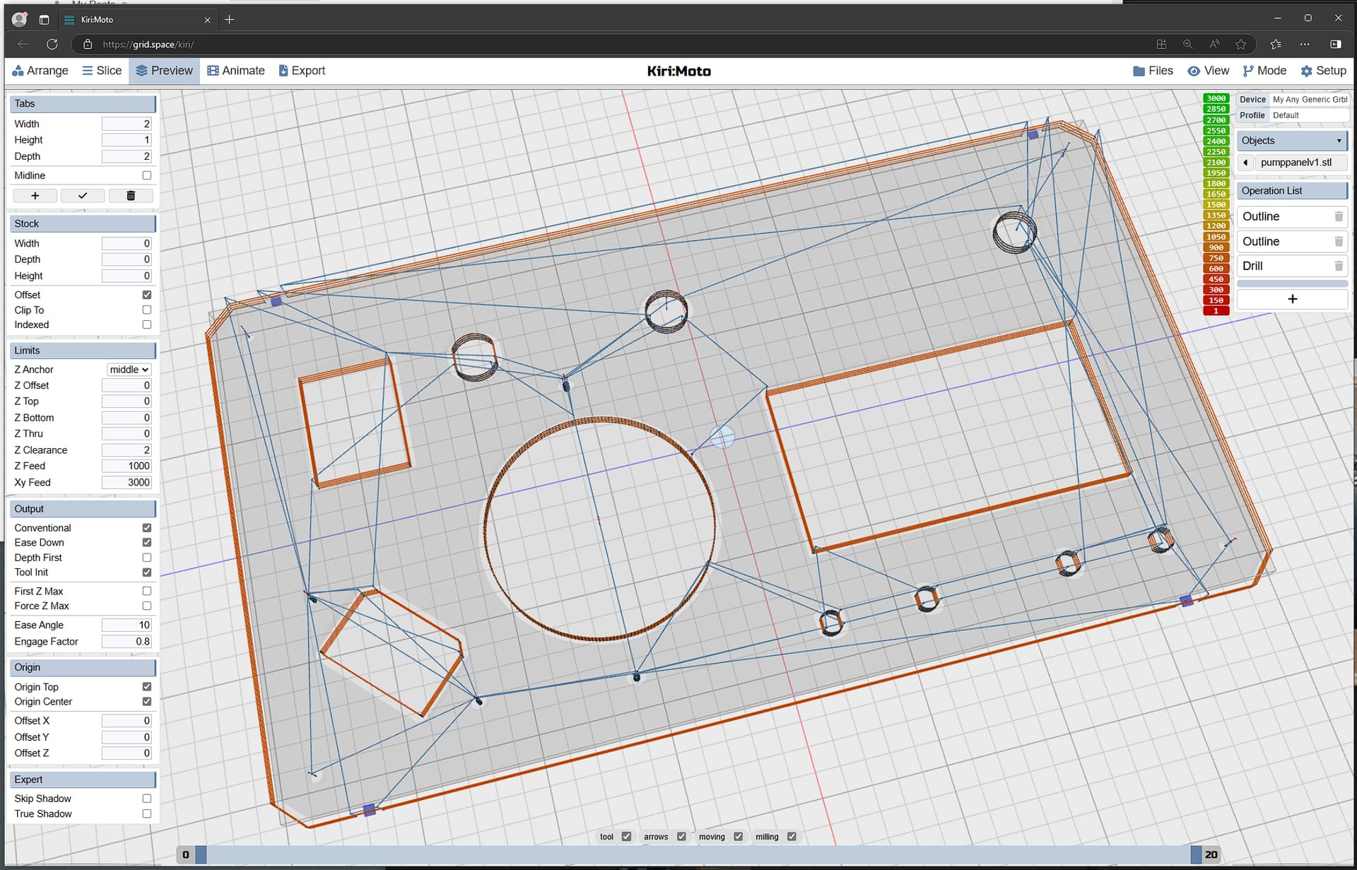

I often use Kiri Moto for cutting out PANELS from thin sheet material, it’s splendid for that task.
It’s fantastic for cutting out the various apertures for front panel controls in one operation and such like and the TABs feature makes it a doddle to then cut out the outline without the whole thing flying off across the workshop when it finishes the cut. :rofl:
But cutting to the right depth and no further is critical so that it cuts through, but not too far into the support material.

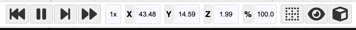

I reworked the CNC animation controls for the 4.1.2 release coming this weekend.
