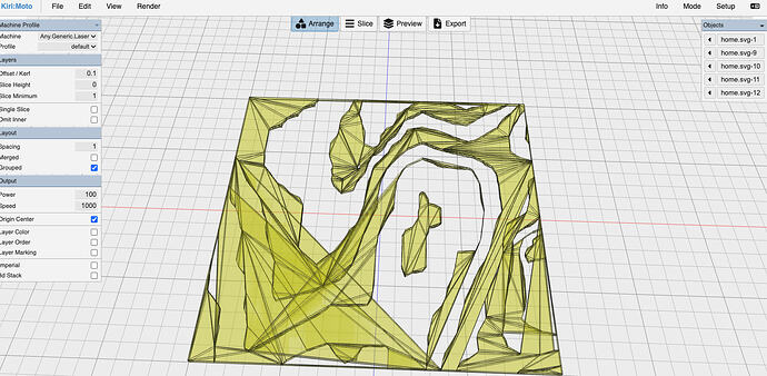

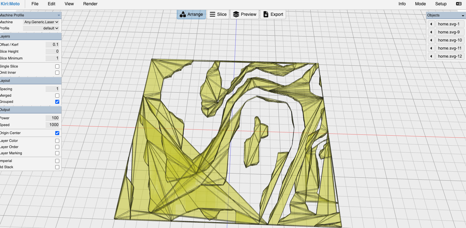

Hi there, I was trying to use this older instructable article to replicate a similar cut with my 3D printer. However, since I’m on the latest version of KiriMoto, I’m not seeing the same options to get my STL file to appear as a contour map. Has anyone encountered something similar? TIA!
you should set the slice height to something other than 0. but it also looks like the STL is non-manifold. can you send me your workspace .kmz (file → export workspace) to [ sa at grid dot space ]
Thanks for the swift response! I’m new to the forums - how do I send the file? or did you mean to email you?
Would love to understand what non-manifold means and how to get the appropriate STL format.
you could email it to the [ … ] address in my previous reply or use something like tempfile.org
