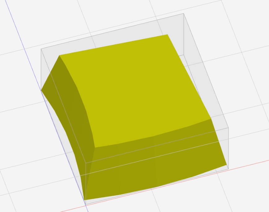

Suppose an object with sloped faces that nearly but not quite align with X or Y axes:
I guess a keycap would be a practical example.

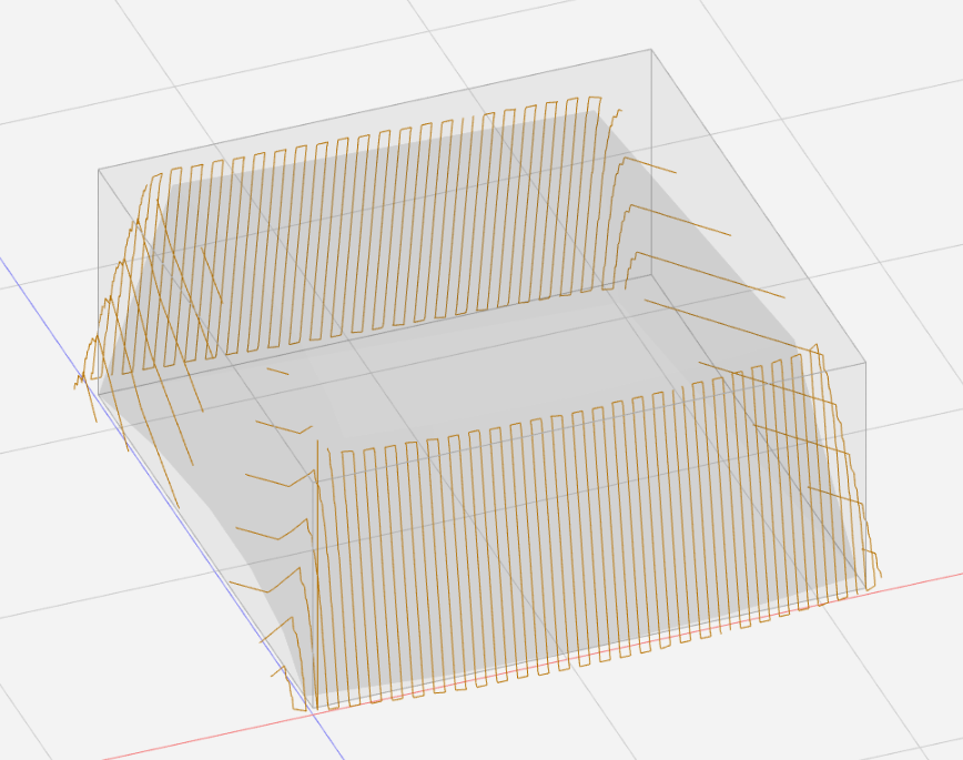

And suppose someone wants to finish the sides with two “contour” operations limited to “curves only”, like:

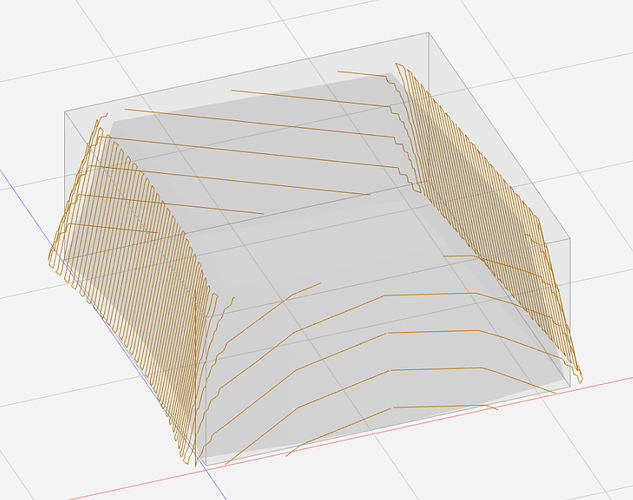

and
Each operation does well for half of the sloped faces while dragging unhelpful marks across the faces that will get treated better by the other operation. Pesky first-world problems :frowning:.
