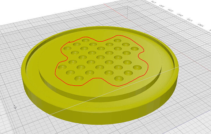

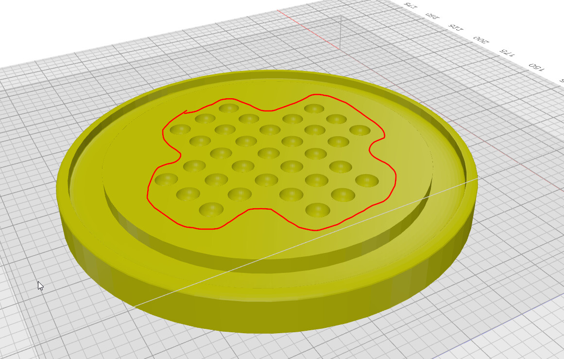

Is there a way to use the contour toolpath of just any CAM toolpath, on a specific feature or region. The demi-spheres need to be cleared with a 3D toolpath and maybe the fillet on the outer edge also.
Is there a way to contain toolpaths or apply them to specific regions this would save a lot of time?

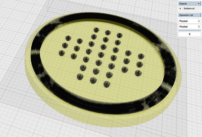

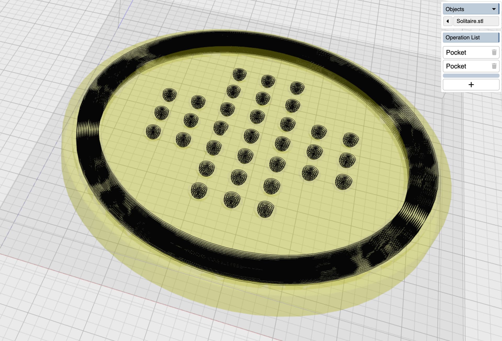

This is a good use case for the pocket operation. Workspace attached
pocketing.kmz (1.8 MB)
Ah nice, I didn’t know about the select button in pocket mode.
The demi spheres I want to cut out using a ball endmill and have them 3d contoured. With the pocket path I’ll end up with a stepped surface.
