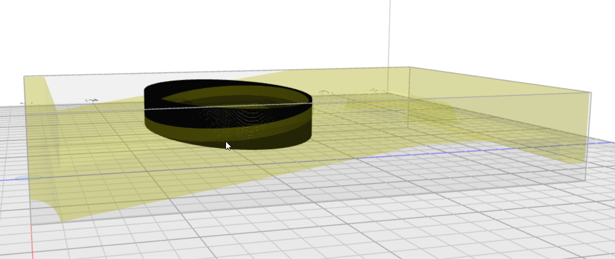

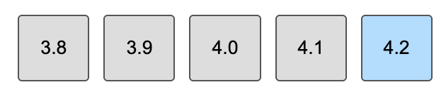

and just in time for you to test the new 4.2 release (KM still defaults to 4.1 so you need to select 4.2 in the version menu).
here’s a workspace with the new trace op if you open KM in a private browsing tab and select 4.2 for testing (then shift+reload the page)
km-42-trace.kmz (411.1 KB)

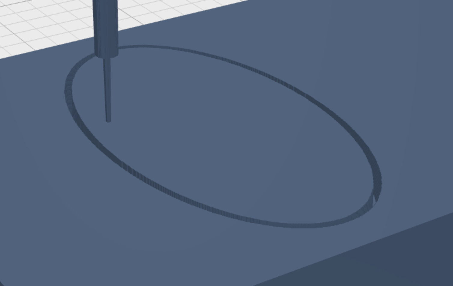

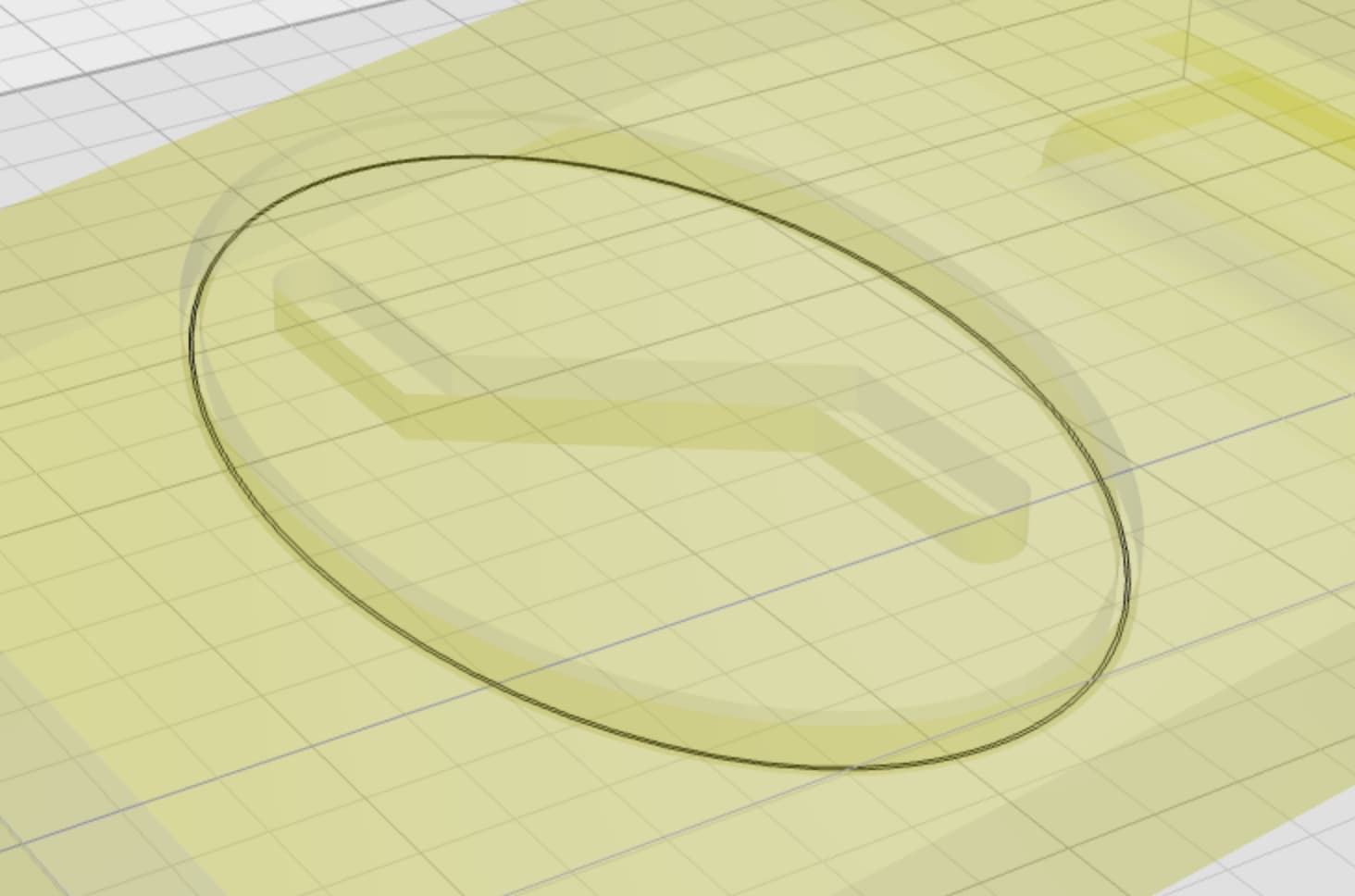

Great work Stewart. I don’t think it suits my needs in this case as it does not respect the slope of the bottom surface - i.e. it mills it to the same depth overall.

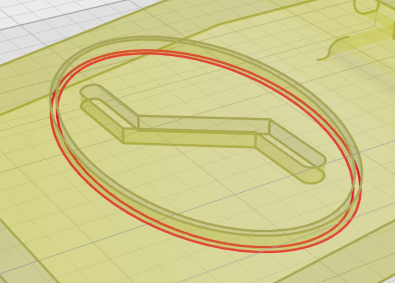

I also can’t seem to sort out the “Select”, so I don’t even know why it’s only applying to the oval.
if you need to step down, yes. when step down is set to 0 it follows the selected lines precisely. it’s possible to add code to clip to the body on step down, but I haven’t gotten that far yet.

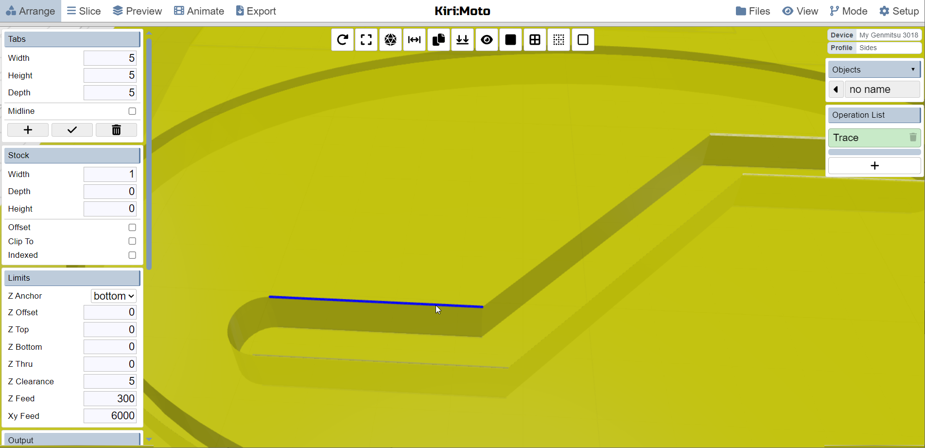

I’m not having any luck selecting for some reason. Is there a technique I’m not picking up on?
if you zoom in on the line does it help?

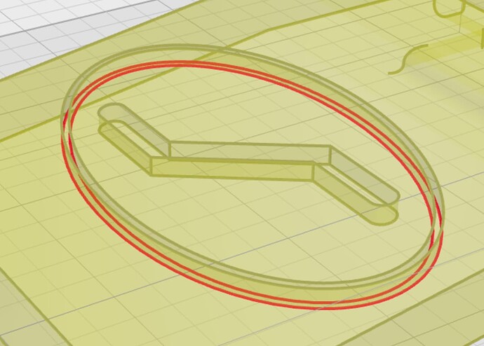

No. Only the straight, horizontal sections of the central logo are available for selection. I also don’t know how it’s already choosing the oval if I select nothing.
odd. try deleting and recreating the trace op.
Behaves the same. I’ve attached my workspace.

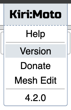

this is a 4.1.10 workspace. you need to use the middle menu version switcher and select 4.2 – then shift + reload as instructed to clear the browser cache
Oops. My mistake. That works as expect. Thank you.
