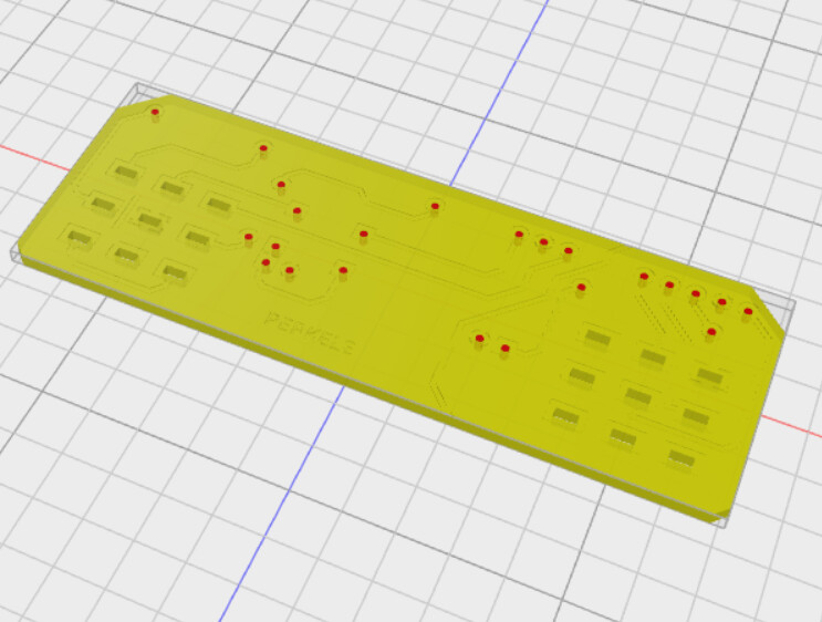

For some reason i can no longer get the drill operation to work. I normallt just use “select matching diameter” and all is well. But that isnt working now. What am i doing wrong?
All holes, except the rectangular ones ofc, are 0.8mm, as is the tool. I usually use a end mill for driling, but i also tried adding a 0.8mm drill.
Thanks for the workspace. There appears to be a bug in the drill code. I’ll let you know as soon as it’s sorted. I’d planned on pushing out an updated point release this weekend.
Cool. I appreciate all the work you put into this. Have a great weekend!
The bug has been fixed, and merged. We’ll have the new release out soon.
