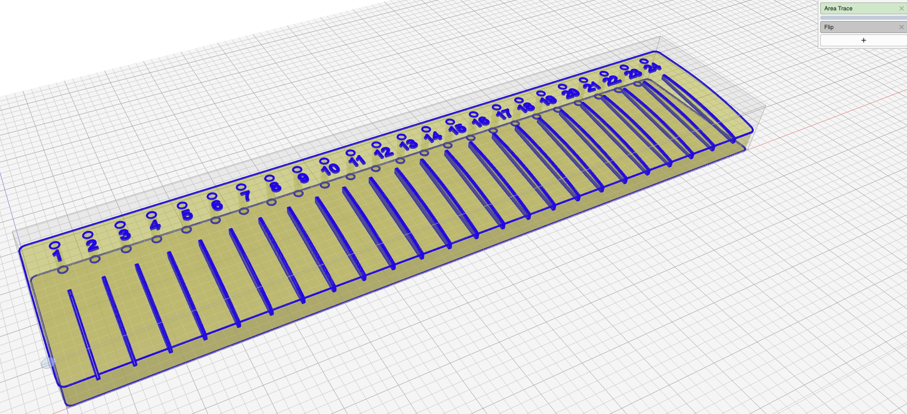

Example odd edges.kmz (4.4 MB)
Sure, here is a workspace showing this odd behavior.
i’m able to select edges as expected. the bottom uses radiused corners so they’re considered continuous vs a sharp angle which would be detected as separate lines.

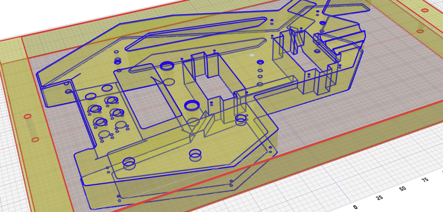

This is weird. Just to be sure, I tested 3 different versions of Kiri:Moto: the web version, macOS, and Windows.
The web version works perfectly fine. However, both the Windows and macOS desktop versions have this bug with edge detection (see the attached screenshot, which clearly shows all edges being selected at once).
