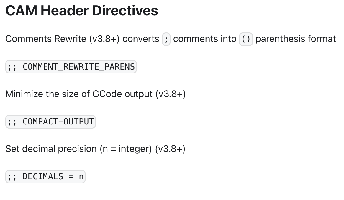

I do not know if the AXYZ machine will accept 4DP yet, once I have loaded it in I’ll know, but pre-emptively is there a way to limit it to 3DP?

N## prefixes are optional on most modern systems and were historically used for things like block/part skips, crash recovery, or crude protocol error recovery. they’re even covered by an ISO standard. you most likely don’t need them unless your controller is specifically configured to require them (which is a setting in some firmwares)
many firmwares / controllers respect ; as a valid comment. if your system does not, Kiri has a device configuration checkbox to strip comments.
