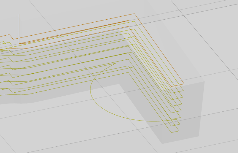

I haven’t used “arc output” yet, but it seems promising for more efficient g-code.
Here’s an unexpected output that would crash:
De-selecting “arc output” cures that.

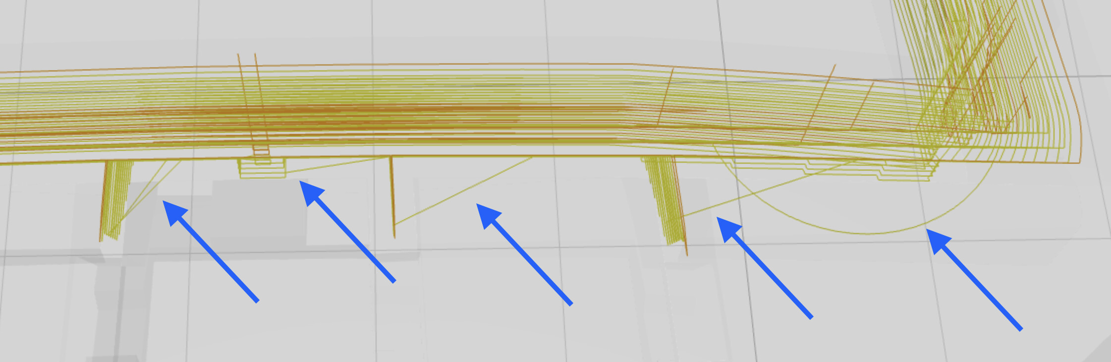

It was a test bit cut from a larger part and I didn’t keep it. Attached here is ̶t̶h̶e̶ (edit: a similar but different) larger part which has a similar but not identical fault in ̶a̶b̶o̶u̶t̶ ̶t̶h̶e̶ ̶s̶a̶m̶e̶ a similar place. I’ve successfully re-imported this one.
The extra arc appears in “preview” but not in the “slice” view. I suppose that’s consistent with a fault in the output processing.

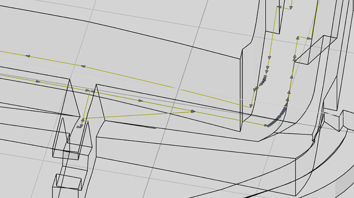

thanks for the test case. these are all errors produced by the arc code that disappear when it’s disabled.
I was able to fix the extra arc generation by turning down the arc tolerance and resolution. not sure what’s going on with the jumps though.
