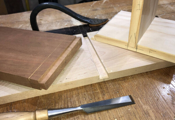

I need to be able to make tapered sliding dovetail slots, where I absolutely cannot plunge into the work -
And I need to do it repeatedly, probably 30 of them a week.
