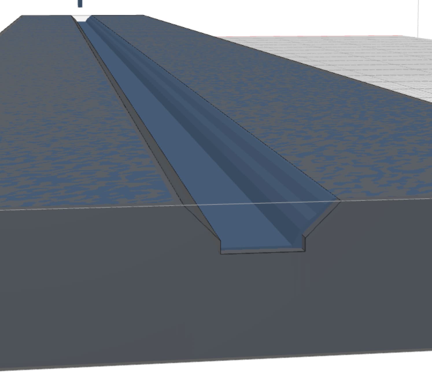

Animation does not show correctly
either the animation is wrong or the cutting path is wrong Or I am missing something
workspace_Part_1 (7).kmz (67.3 KB)
animation is an approximation with the resolution of the grid set in preferences. yours is on the lowest / least accurate setting (100) which looks like this:

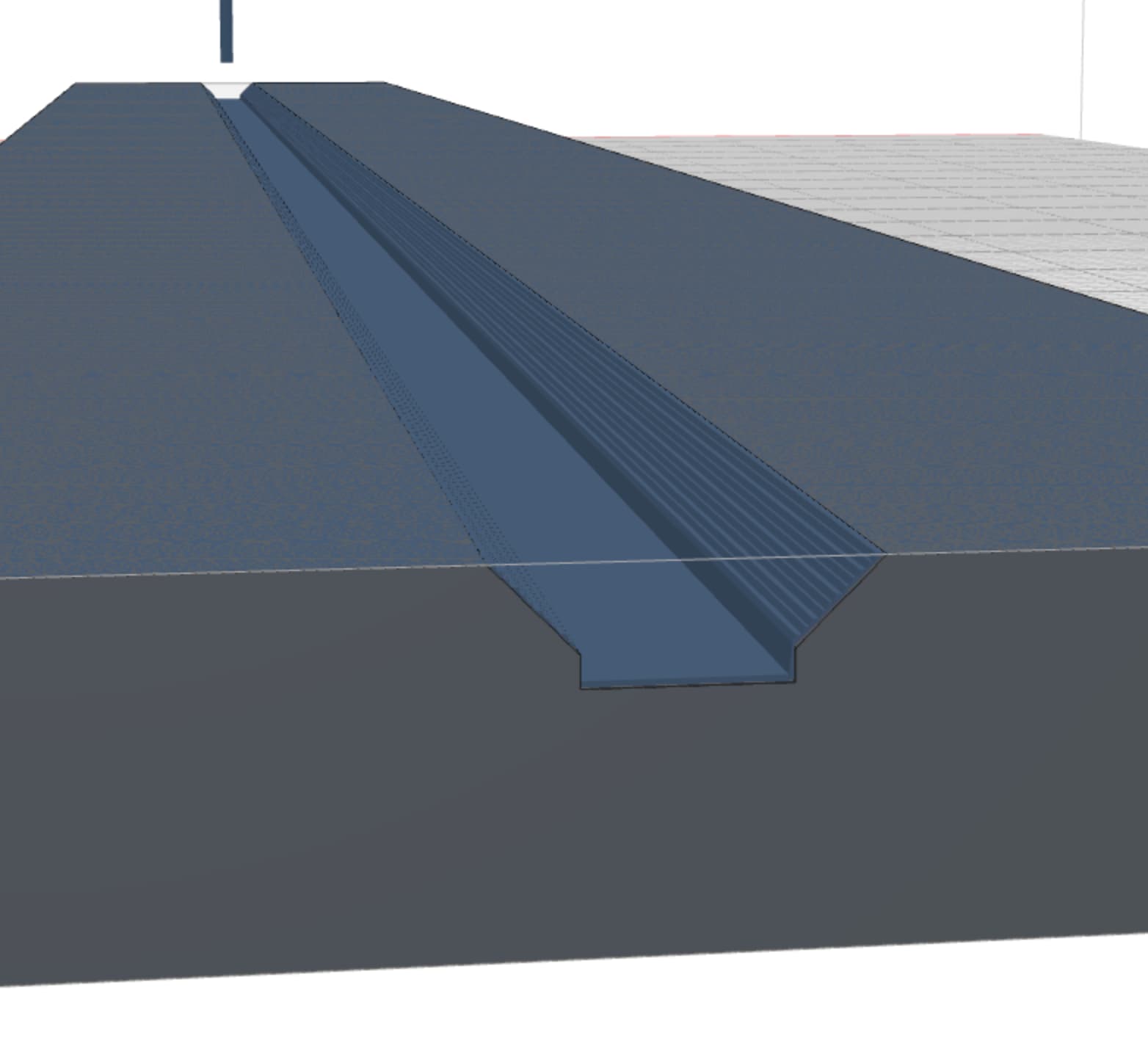

when I raise the value to 4000, the max, it looks like this:
