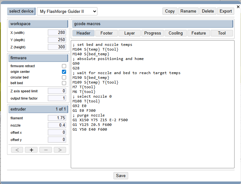

Just recently purchased an Adventurer 5m Pro. Trying to use KiriMoto for slicing however having some issues. When I upload a gcode file to Ad 5mPro, the printer finds it and ‘starts’ printing, goes through normal warm-up and preheating, runs a small extruder clearing at the top of the base plate, centers on the baseplate, then extruder seems to reset and goes to the back right position, and the baseplate moves down to the bottom position. On the screen the file shows as printing, but nothing happens. Extruder is not running, baseplate in bottom position, temperatures where they should be, but nothing prints.
I have somehow managed to print a couple of items, but have not figured out anything as to the difference between the successful items, and the failed items. Below is a copy of the current gcode that keeps doing nothing. I have compared to a successful print and everything looks identical. Not sure why it keeps ‘not’ printing. I can see it in slicer and preview mode no issues. Any thoughts???
I don’t see anything obviously wrong with this gcode header macro. If everything else looks normal, this behavior sounds like a possible printer problem.
thank you Stewart for your feedback. and I apologize for not following up sooner. I was never able to get any of my or other downloads to print, however I finally changed the machine preferences from the Flashforge Guide II and changed it to the Flashforge Finder. since changing I have been able to print everything that I have tried. I am sure that the fault lies in the seat that I am sitting in, however I’m just not that smart yet on 3D printing and the codes yet.

it looks like the Finder gcode header has some proprietary firmware configurations. I guess that’s shared with the Adventurer. the Guider header is more standard.
