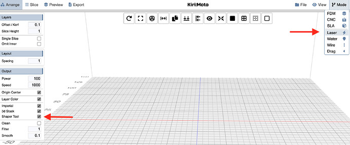

Hi there. I have a Shaper Origin. I’m new to Kiri:Moto, but can’t find the option for Shaper Origin anywhere in the menus. Is it available in the current production version please?

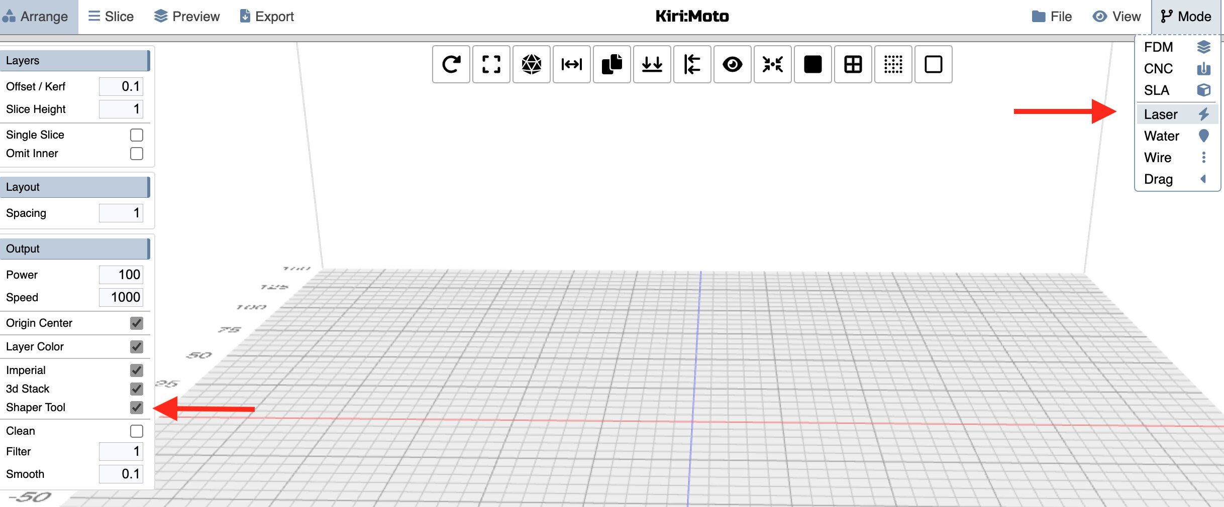

Hi, you need to change the mode to laser and it will be a check on the left menu.
Thanks for the speedy reply @arx237 ! That worked :+1: The screenshot was super useful. The Shaper Tool option only appeared once I clicked the “3d Stack” option.
that’s right. 3d stack outputs layers with Z height annotations that are not present in classic 2d laser output.
Sorry forgot about that, mine is conveniently checked on page refresh :slight_smile:
