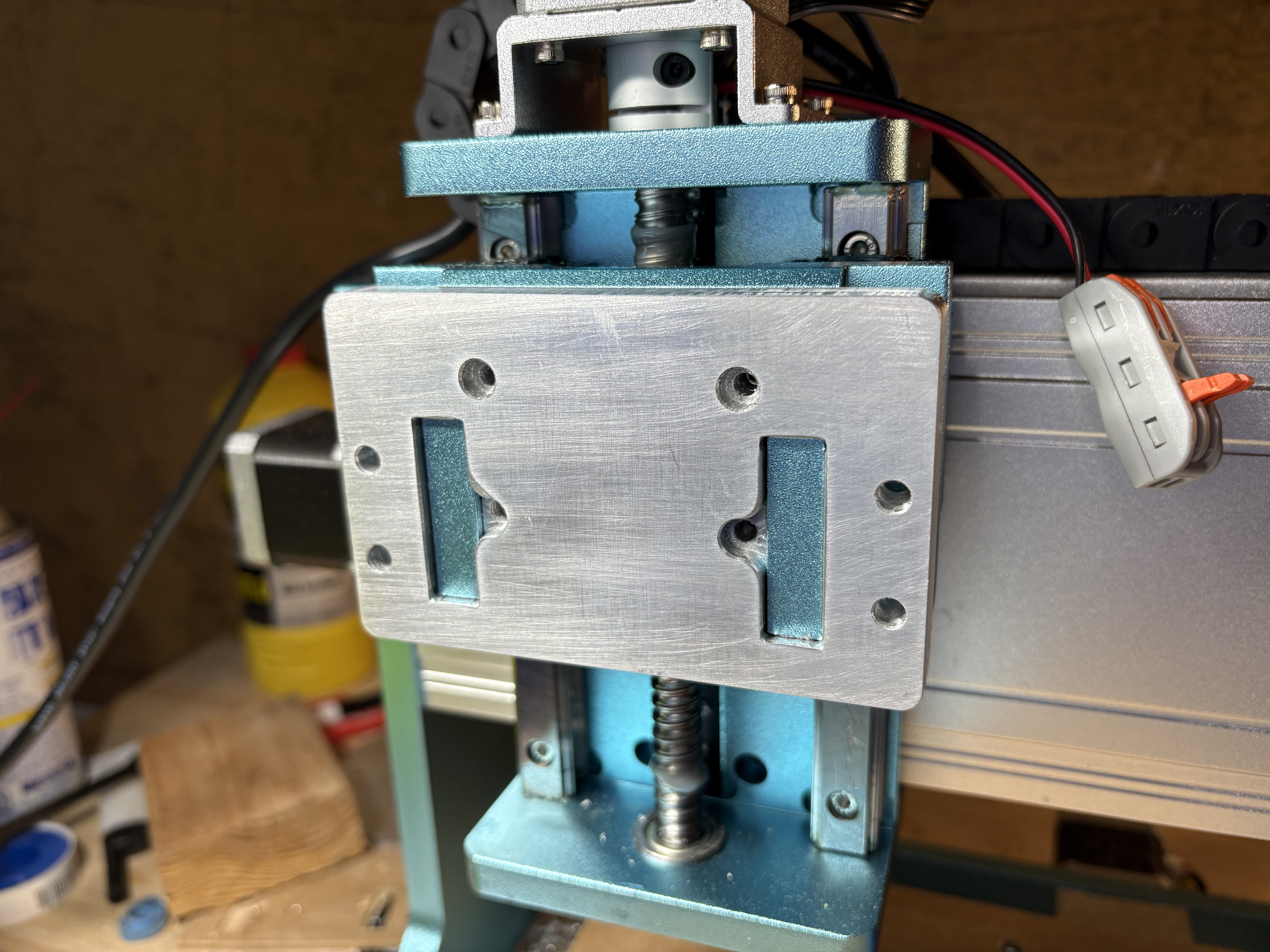

Adapter plate for a 1.5kW spindle on my Genmitsu 3030
The 12mm aluminum plate has been designed in onshape and machined on the stock 300W spindle. Took about 3 hours. 500mm/minute, 0.2m depth of cut, 6000 rpm, single flute.
nicely done. really putting the stock spindle to the test.

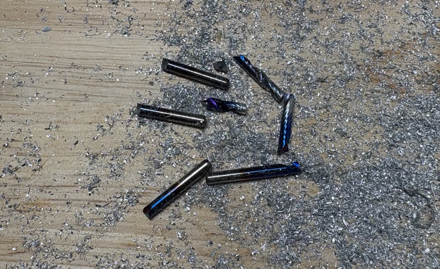

There were casualties :sweat_smile:
Their sacrifice will be remembered
I have been using Chat AI for my speeds and feeds.
Step file? Would save me some time measuring and im sure help a lot of people.
I created an upgraded version. You can download the STEP file from my website at 80mm Spindle Upgrade | Moe's Machines.
