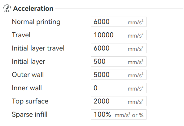

I mean acceleration setting,like this picture
I see. there is no UI for this at present. you would have to add a conditional IF/ELIF script in the features macro tab that injected the right klipper commands for matching features (which are print areas). yes, this is clunky and can be improved. but this project is just me in my spare time (for 14+ years) … so PRs and contributions are welcome to speed things along.
I see. I’ll give it a try. My programming skills are not that great—I can only write some Windows batch files.
