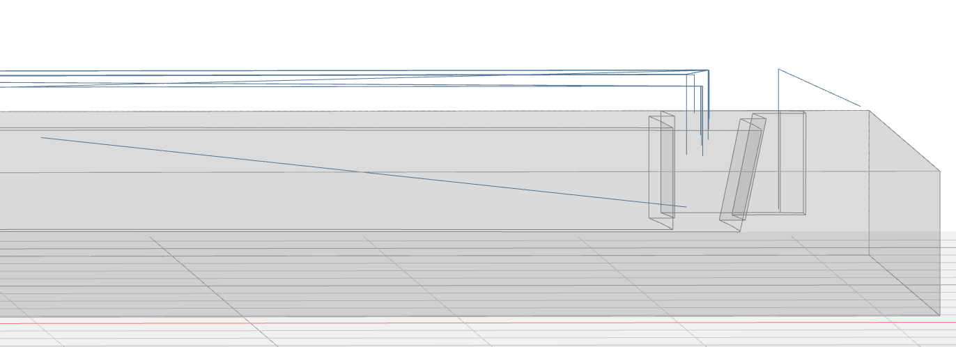

4.5 roughing crash move thru part
This might be a side-effect of the roughing op tacking a stock clear on at the end, without an intentional transition, when ‘clear faces’ is selected.
This workspace again, but with ‘clear faces’ selected:

this has been fixed on the dev server
