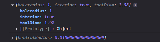

You’re selecting a hole with a radius of 1 and using a tool with a radius of 0.99
It them follows that your helical radius should be 10 microns (very small lol🔬).
I intended helical tools to have their width set based on the diam of their shaft, not the diam including their teeth. which way are you setting it?
Again, sorry for the confusion. I can add some docs to [https://docs.grid.space](the docs) when I get time. in the meantime, I added the offset option:
So that you an set your helical toolpath to whatever, regardless of how you are plugging in tool widths.
Hope this is helpful. please ask if you have questions about anything else.

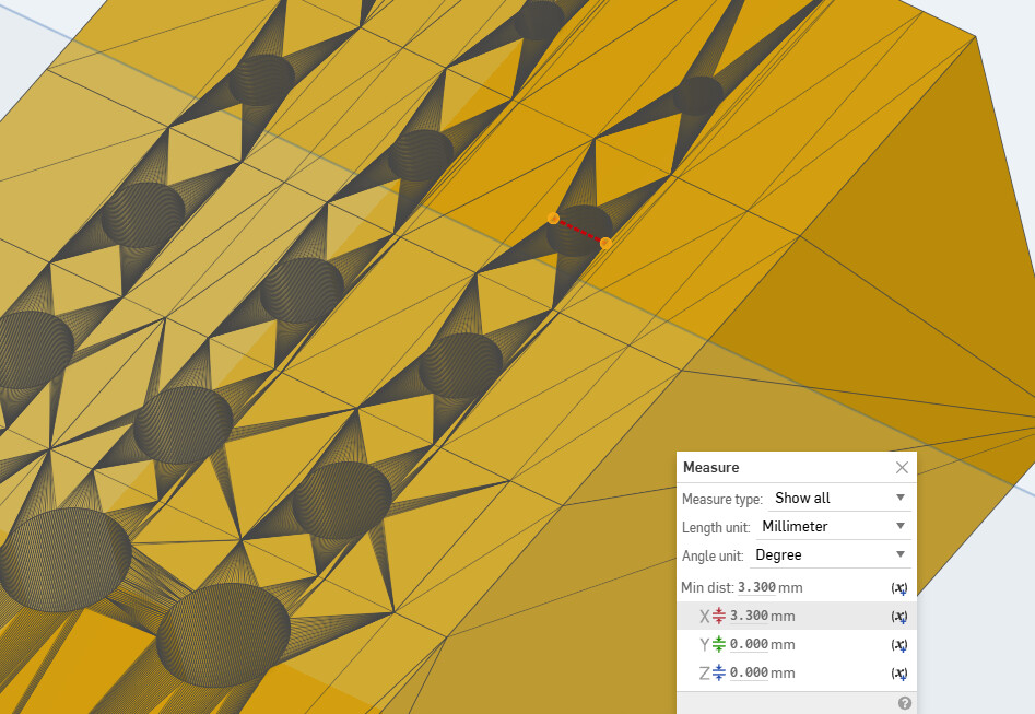

No, that’s not right, the hole is 3.3mm in diameter.
can confirm. gonna dig a bit more.
Turns out I’m just incredibly foolish.

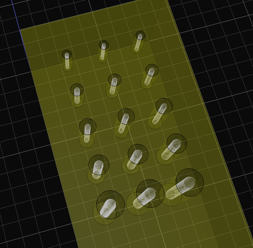

Yes, this looks right:
I’m going to run it in the CNC tonight when I get home :slight_smile:

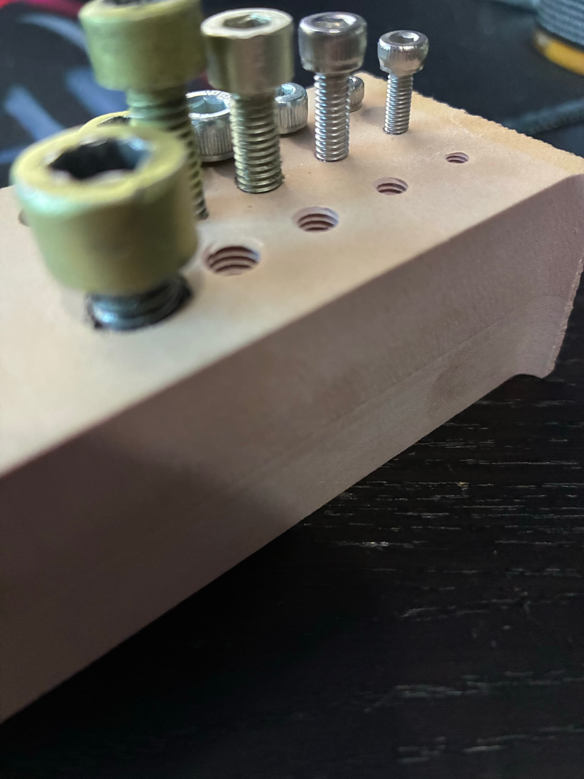

I did a IRL milling with sickablock:
Everything went as expected, there is 1 issue though, by my mistake I drilled the M8 too deep also I created the tool with 25 mm in stead of the real 20 mm (that’s where I went wrong, I used that info to make the hole).
Resulting the bit dropping in too deep and hitting the sides of the hole with the shaft. luckily it’s sickablock and nothing bad happens.
I’ve changed the settings in the bit and sliced it again but it still drops down to 25, the hole depth, maybe you should prevent us from making this mistake to check if the bit is capable of that depth.
And maybe make a depth limit option or something, so I can set it manually to 20 even if the hole is 25 (I think you want the hole about 1 mm deeper than the thread anyway).
Otherwise though, pretty awesome! :slight_smile:

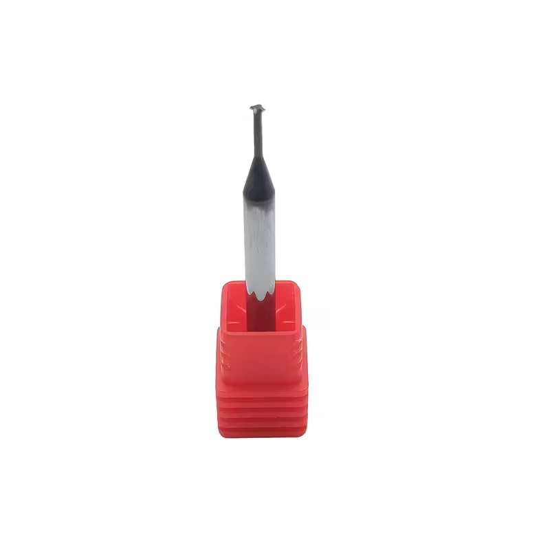

Could you please link to the tool that you are using for threadmilling?
I don’t have a specific link for you, but you can buy them everywhere they well CNC bits, they have 1 tooth but you get them for different sizes, like I have 1 for M3, M4, M5, M6 and M8
the thicker ones go deeper, but I think you can mill an M6 with M3 bit, only the depth is a problem.
They look like this (search for Thread milling CNC bit at your favorite shop):
